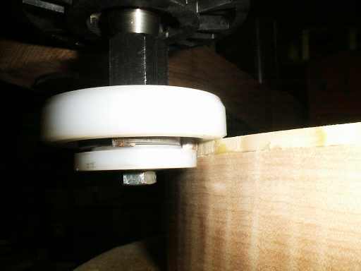

I built this several years ago and, yes, it's for the binding and purflin rabbets. The cutter is an off-the-shelf 3-wing slot cutter. I have a set of rub collars for my standard binding and a set for the purflin. The cutter is just under 2" diameter which seems to minimize any tendency for tearout.
The guitar body mounts on a turntable and the router mounts in the end of an articulated arm.

Here's a "less large" shot of it in action. I replaced the UHMW pilots with aluminum later on.

Nice Nelson. I can sure see where a 2" blade would provide a better cut. What do you have it attached too?

Don--I made an arbor to fit the 1/2" router collet. The arbor has diameters machined to fit the bearings as well as the cutter hole and threaded on the end for the 5/16" nut.
